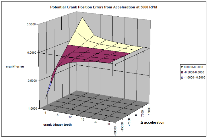

Let’s look at what happens when an engine is subjected to varying degrees of Jerk at RPMs of 1500 to 7000, with crank triggers from 4 teeth all the way up to 60 teeth, and changes in acceleration rates (Jerk) from -30000 to +15000 RPM/second.
Drawing from simple physics, I’ll use a formula to calculate a linear change in velocity from a measured initial velocity, acceleration rate, and time and then compare to a recalculation of the same equation with a new, increased or decreased acceleration rate:
vf = vo+at2
Where:
vf = velocity final (RPM)
vo = velocity initial (RPM)
a = acceleration rate (RPM/second)
t = time (seconds)
We can take the difference in calculated velocities and convert that to crankshaft position in degreees since we know there are 360° for every rotation, and 60 seconds for every minute.
position = (V1-V2)t x (1 minute/60 seconds) x (360°/1 Rotation)
Where:
V1 = velocity from known acceleration rate
V2 = velocity from changed acceleration rate
t = time (seconds)
1 minute/60 seconds = units conversion for minutes to seconds
360°/1 Rotation = units conversion for rotations to degrees
For simplicity, I’ve run the calculations for 1500, 3000, 5000, and 7000 RPM and graphed the results below. Positive numbers means the crank position will be ahead of the predicted position, so the timing would be retarded – likewise, negative numbers means the crank position will be behind the predicted position and timing would be advanced.
Conclusion
It’s clear from the graphs that as the RPM increases, the amount of potential error diminishes. Also, we can see that the 12 tooth error at 1500 RPM is below 1° for changes in acceleration rates of ±15000 RPM/second. Yes, the 36 tooth has less of an error than the 12 tooth, but keep in mind these scenarios assume the worst case where there is a change in acceleration after the last tooth event recorded by the ECU. I will argue that the timing error difference between 12 teeth and 36 teeth is not worth worrying about for two reasons:
